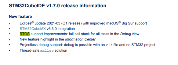

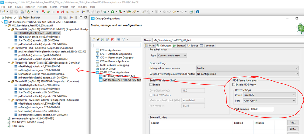

I'm working with the "NUCLEO-U575ZI-Q" development board and I compile using STM32CubeIDE 1.6.1. My project uses FreeRTOS and if I debug my project and halt execution, then I can see the currently executing thread's stack trace in the upper left part of STM32CubeIDE and the current line of code of execution is highlighted. Is there a way to someone (not necessarily inside STM32CubeIDE) show the stack traces of all threads? And, as a bonus, is it possible to show/highlight the lines of code that each thread last executed on?
Wijeden RHIMI
Hello @arnold_w,
In cube 1.7.0 and the later versions you have the features that you need, and you have to enable it in the debug configuration.
Maybe those two screenshots could help you:
 0693W00000WJyYOQA1.png0693W00000WJyY9QAL.pngwijeden,
