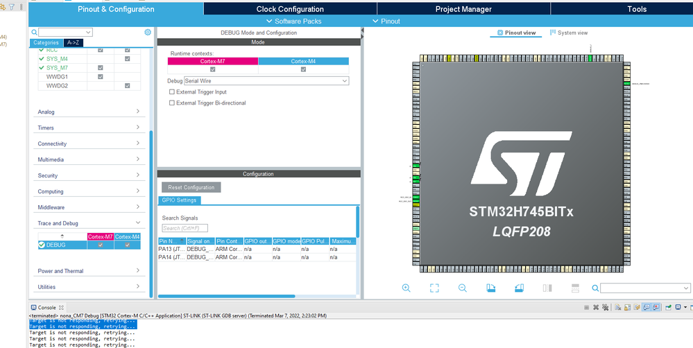

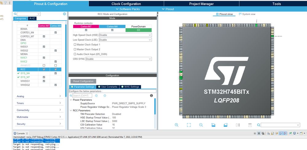

i am using a dual core STM32H745BIT6 and i am using an internal oscillator, i am having some issues
‎2022-03-07 11:26 AM

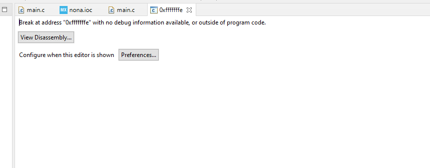

problem:
- this occurs when i launch the debugger "Break at address "0xfffffffe" with no debug information available, or outside of program code".
- when i click on resume debug then its like i disconnected the jtag it says "Target is not responding, retrying..." and then shutdown..... then says EXIT.

Suggests it is reading 0xFFFFFFFF from one of the vector tables, as you've written FLASH section for one of the cores, and not the other.
Other tools merge the M4 .HEX into the M7 .HEX before writing the combined image.

#define VECT_TAB_OFFSET 0x00000000UL /*!< Vector Table base offset field.
This value must be a multiple of 0x300. */
is it this one?

Have a look at this app note on how to setup a project for STM32H7 dual-core debug:
I think this is a good first step, it covers also how to load both elf-files in one debug configuration.
Then, let's see if your own configuration in MX actually impacts the behavior.
