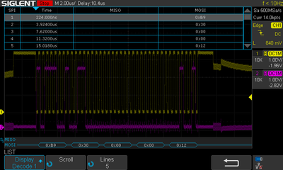

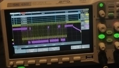

Hi! Do we have write acces on pin set to alternate function push-pull?
Problem: CLK line floats after hal_transmitreceive, pullup helps but distorts clk line.
And with pullup there seems to be a glitch at end that slave can detect as fake clock cycle and push MSB out of its scope and add to end radom bit.
Should i go with LL spi will this help?
Attachment: clk with pull-up, yellow - clk

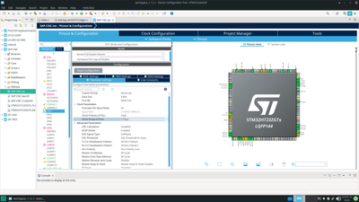

Which STM32? Some models have a setting that releases SPI pins after a transaction. If this is your case, disable releasing the pins.
Its STM32H723ZG
How to disable releasing the pins?
Master keep io state : enable ?
Or should I set AFCNTR in SPI_CFG2 (bit 31) "LL_SPI_EnableGPIOControl" in the LL library?
Yes exactly. Enable Master Keep IO state.
This should work for what you want. When the SPI is disabled, the pins will still be driven.
