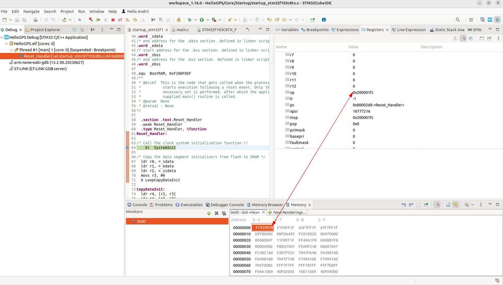

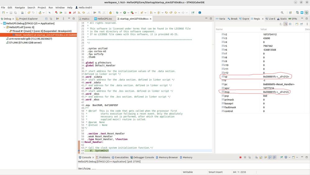

I am absolute noob with stm32 and i am currently trying to connect GY-GPS6MV2 module to RobotDyn STM32 Mini(STM32F103C8T6).  I have connected GPS module to pins and set up USART1 in asyncronous mode. I have done everethyng according to official example on how to work with USART1 using DMA. In the interrupt handler i wrote small piece of code to copy data from rx buffer to linked list. But from here things have gone really weird, because in the debugger i see, that my global variable(nmea_head, this is first node in linked list) is allocated in the same memory area where irq handler stack resides(See attached screenshots). What am i doing wrong?
Here you can see, that SP for HAL_UART_RxCpltCallback is at 0x20000104
This is definition of global variable nmea_head. On the right side you can see, that it was placed on the address 0x20000110. This address overlaps with stack frame of HAL_UART_RxCpltCallback, so my variable gets corrupted. What am i doing wrong?
This  happens prior to any calls to malloc or free, and i am not accessing this variable from anywhere else, so there should not be any race conditions.

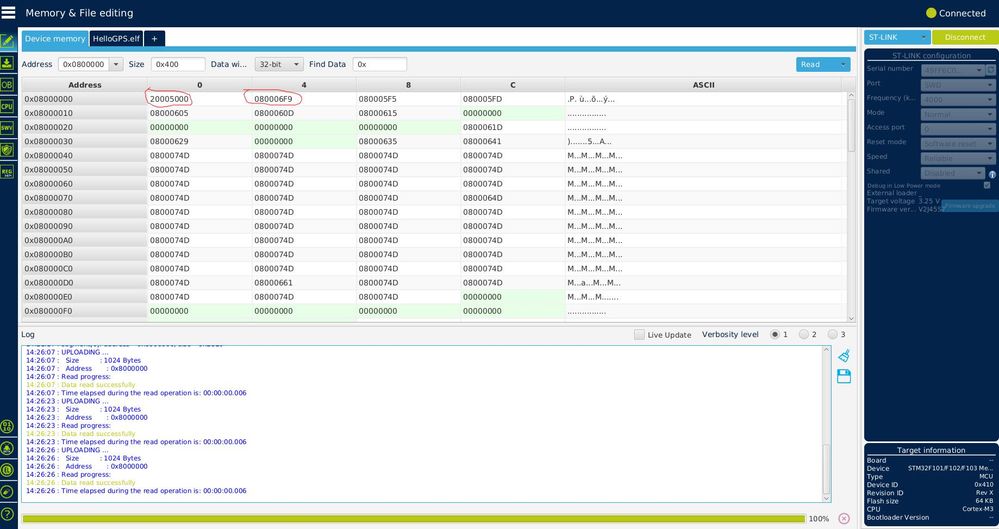

I checked memory with STM32CubeProgrammer
0x20005000 is correct value for _estack and 0x080006f9 is address of ResetHandler
So this should mean, that chip should start directly at Reset_Handler without any prior bootloader and msp/sp values should be 0x20005000, right? Because when i break at reset handler i see something different:
BigBrick
I ckecked memory during after reset:
This is why i have invalid SP/MSP. But where does this value come from?
Looks like the MCU is booting from system memory. The next address (initial PC) is in the System Memory Area (0x1FFFF000-...) with the internal boot loader. Maybe such a little stack space is okay for that boot loader.
The board should have a BOOT0 pin/jumper that must be set to low for booting your code from user flash area (0x08000000-...)

Thank you, setting BOOT0 jumper to low fixed it.
