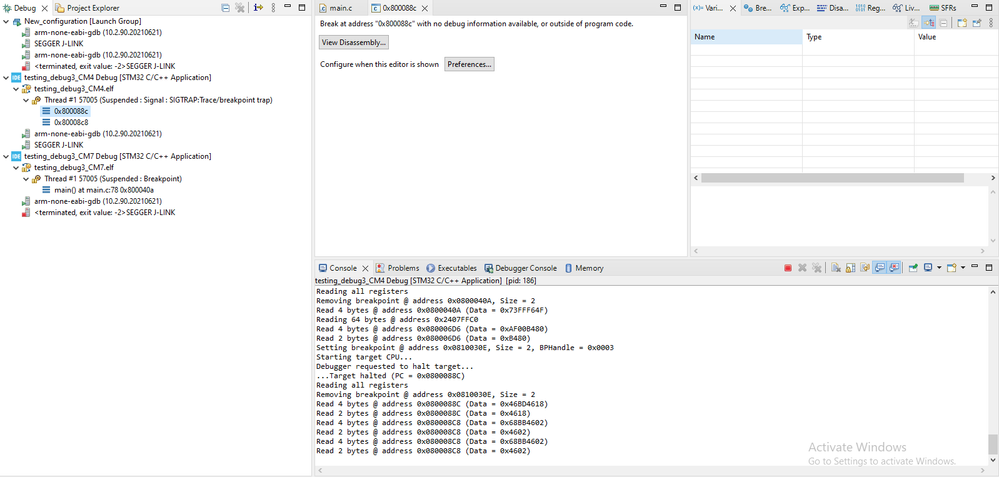

Hi @F.Belaid​ I followed all the steps but it did not help. Sometimes the error "Could not verity ST device" come and sometimes the M4 core gets stuck in another error "break at address 0x... with no debug information ..."
Image attached showing error

Hi @Community member​ ,
Sorry for a later reply, thread was brought to my attention today.
When debugging dual-core devices you need to tell the debugger which core to connect to. With SEGGER I believe that the access ports managing the communication to the different cores are hidden behind "device names". So, to communicate with the M7 core, you have to specify the :
STM32H745XI_M7
For the Cortex-M4 core the device name should consequently be set to:
STM32H745XI_M4
Does it help?
