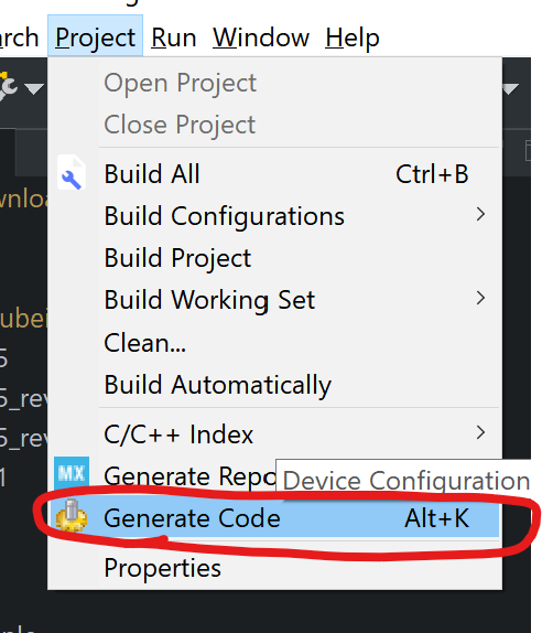

in stm32cube ide, making a new STM32 project, i get the Initialization of all peripherals dialog but not the STM32CubeMX perspective opening dialog - it used to appear, now does not - how do i get it back again?

Double click the .IOC file in the project.

thanks very much TDK.
but now i am muddled ...
in the top right there is the MX icon which goes to the same place you point to
which is the CubeMX perspective, no?
CubeMX is the pinout and timing graphical setup, yes?
under Code Generator i am getting only the code generator page
with no button or page to actually generate code.
dismissing this page [the CubeMX page gives me the project page
with file on the left, editor in the centre.
Correct on both points. CubeMX is a standalone program but they've integrated it into STM32CubeIDE for convenience.
After editing the pinout or making other changes, save the IOC file (File -> Save). Then select Project -> Generate Code from the menu to regenerate the code.
You can also right click the IOC file to regenerate code.
