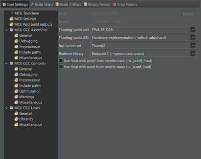

Why does this warning show up every time I create a project. Is it something important, how do I get rid of it if I need to. I checked the settings and I initialized the FPU in properties.

The tool settings allow the compiler to generate FPU instructions but you still need to enable it within the code itself.
#if (__FPU_PRESENT == 1) && (__FPU_USED == 1)
SCB->CPACR |= ((3UL << 10 * 2) |
(3UL << 11 * 2)); /* set CP10 and CP11 Full Access */
#endif
