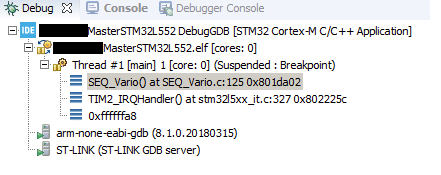

I used to work with IAR.
In IAR call stack, if ever you break into an ISR, the call stack shows you where you were in the "main" code just before the ISR fired.
Now, with STM32Cube MX, the call stack only shows the call stack since the root ISR function, but we don't know which function has been interrupted.
How to read this info ?
Thanks.

Best answer by mattias norlander
This is a known issue. We have discussed this with Arm a quite long time ago, but back then it was in the context of TZEN=1. The issue seem to be similar with TZEN=0 which I think is news to us.
From your screenshot we can see that you are running the gcc-7 from 2018. We now also deliver the gcc-9 from 2020, however we don't think the issue is fixed there.
The root-cause of the issue is that GDB is not yet cortex-m33 aware with respect to stack unwinding. The 0xffffffa8 is a magical pattern (EXC_RETURN) that GDB does not understand. Hence it cannot properly do the stack unwinding. If you later use TZEN=1, the issue I described in my last post will apply.
So, sorry, I see no way forward with the current versions available of CubeIDE and the bundled toolchains. The only thing I can say is that we have tickets for this and have requested a fix from Arm.

You usually get what you pay for. And the Cube compiler is free ...
You can note down the stacked return address, and cross-check with the map file manually.
Or go back to IAR.

Device : STM32L552 with TrustZone disabled
Debug probe : ST-Link V2

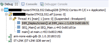

call stack displays normally (up to the "main" function) when not in ISR (see below)
0693W000006EKA8QAO.pngcall stack only shows functions up to the root ISR function, when in ISR (see below in TIM2 ISR), whatever ISR (UART, USB, etc..)
