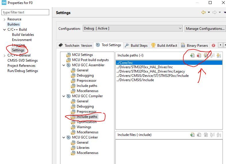

Right click on your project within Project Explorer then "Properties"

Project->Properties->Tool Settings -> MCU GCC Compiler -> Include paths Add "Drivers/BSP". It is visible as "../Drivers/BSP" Any suggestions as to how to make that line effective?
‎2020-07-24 7:55 AM

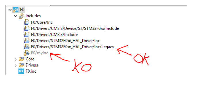

Is such line effective from Eclipse point of view already ? Please could you check if such line is leading to plain or grayed include like following sanpshot ... if grayed means Eclipse not able to reach
‎2020-07-24 9:11 AM
Thanks. Good find. I did find one bad directory which starts with a "/". How do I get rid of the bad one? How do I replace it with a good one with no '/"?

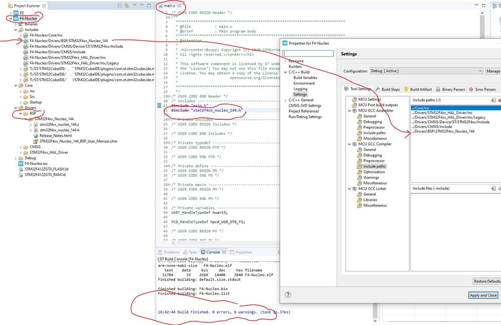

‎2020-07-24 9:34 AM
As addon here is my setup adding BSP without any issue
‎2020-07-24 10:36 AM
Thanks again. I'm back in business.
