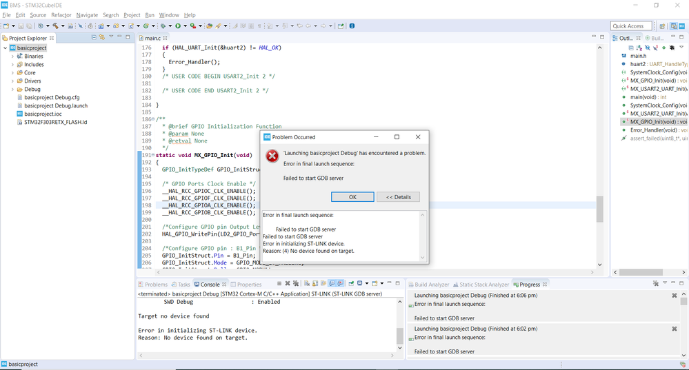

I am using a Nucleo F303RE board. And whenever I try to debug in STM32cubemxIDE. It always shows an error for failed to start GDB error.
I have updated the ST-Link firmware and also checked my device manager.
I have also tried disabling my windows defender.
I have also tried to change the frequency, interface, auto-connect under Debug Configuration.
Would be great if someone could help me out. I am stuck with an important demo at work.

I faced similar problem. I uninstalled and installed version 1.4.0 and things are fine now.
