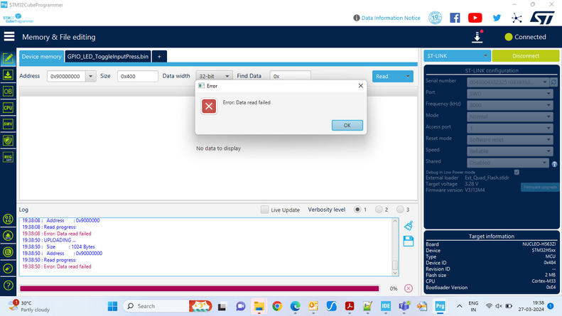

I am using NUCLEO-H563ZI evaluation board and i want to create external flash loader for IS25LP128 QSPI flash memory. I used external loader files from GIT HUB and .stldr file in STCUBE programmer external loader folder location. when i try to read from 0x90000000 location, i am getting read failure error. I used the below path to create external loader for IS25LP128 QSPI flash memory,
stm32-external-loader/Loader_Files/other devices at contrib · STMicroelectronics/stm32-external-loader · GitHub
Could you please help me to solve the below issue?
>>What could be the reason for Init function not called?
I don't know, use your imagination.
Set the STM32 Cube Programmer side to Verbose Logging Level 3, see what it's doing.
Make sure it pulls in the loader image to RAM, that it correctly identifies the Init() entry point, and calls it. Use objdump or fromelf to dump/disassemble the .STLDR

Test and debug your loader and BSP code in application space, using a harness or fixture to allow you to exercise the basic functionality.
With the loader you can use any/all of the resources of your hardware, ie UART/VCP, to provide diagnostic and telemetry as to what's happening internally. The interactions on the STM32 Cube Programmer side can be seen via the log at an appropriate verbosity level.
Here Init() or Read() function are not completing without an error/failure. On a NOR_FLASH Init() is expected to memory map the device, and return without an error.

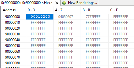

While debugging i found out that if it is charcter string, i am able to wirte n number of bytes but if it is numerical value, i am able to store only 8 bytes.
for example, i am trying to store 1 to 24 values in flash but it is storing 1 to 8 only after that it is writing/reading some junk values. Could you please help me to solve this issue.

Likely an issue with the write code not shown. Either the transfer or waiting for the completion. Don't view the peripheral registers in the debugger, it will break the FIFO
