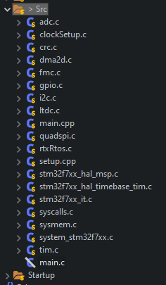

since I have upgraded to 1.7.0 a few of my C++ projects stopped working. When I code in C++ I always create main.cpp file and I exclude from all builds main.c file (I don't delete this file as it is always generated by CubeMX). This has been working for a long time.
But now it crashes. It still try to compile main.c file. What's more, if I delete main.c file, linker tells me that it cannot find main symbol. For some reason compiler doesn't compile my main.cpp file. I have C++ nature set up and all other .cpp files are compiled, but not the main.cpp...

Maybe more descriptively:
When I start a C++ project for research purposes I always use HAL libraries and project structure generated by STM32CubeMX. By default a file main.c is created with necessary initialization code.
I always create my own main.cpp file and copy necessary code from main.c, and I add my custom code to call some objects and do the job. At this stage I have two main files and two definitions of main(). In order to get rid of multiple definitions I always enable "Exclude from build" options for original main.c file (I leave all its content).
I do the same with a few other automaticaly generated files, but for a sake of simplicity lets focus on a main file and main() function.
For all previous STM32CubeIDE versions it works as expected - g++ compiles main.cpp file with main() function and the compiler ignores main.c file with all its content.
When I updated my IDE to 1.7.0 it stopped working. During the compilation of the same project it suddenly says that I have multiple definitions of some functions (Error_Handler(), assert_failed()). I always copy those functions from main.c to other custom files. This means that for some reason compile ignores option "Exclude from build" and still tries to compile main.c. Whats more, it doesn't "see" the main.cpp file, so when I comment out all code from main.c it crashes, because there is no main symbol.
All in all, compiler compiles files that shouldn't be compiled (marked as "Exclude from build") and skips some files that should be compiled. Sure, I could rebuild the entire project from scratch or delete problematic files, but I do expect from the IDE not to break my projects and work out of the box. It was working for a long time until 1.7.0 release.
I went back to 1.6.1 and the project started working again as it was. So I will wait for a new release. But maybe this is some kind of bug, that is why I posted this.

Exclude from build is build configuration specific. Ensure the active config is the one you're actually building. Should show up grayed out in the Project Explorer.
Yes, I have created new clear workspace for 1.7 and imported project into it as it was working in 1.6. I will try to reproduce it later when I get back to home.
aroni525
Ok, maybe I didn't wrote it clearly enough.
When I mentioned duplicated symbols I meant i.e. functions like Error_Handler(), assert_failed(). These functions originally exists in the main.c file. I copy them to the, lets say, setup.cpp file. Then I copy the main() function to the main.cpp file.
I exclude from the build file main.c as I don't need it. Remaining two files main.cpp (with main() function) and setup.cpp (with other functions) contains all necessary definitions.
During the compilation I can still see gcc compiling main.c file, g++ compiling setup.cpp file (here are duplicated symbols) and the main.cpp file is ignored.
My active config is always set to debug. The icon is crossed, but not grayed in the Project Explorer. Now the question why...

Hi Arek,
sorry but I can't really help you, but I have exactly the same problem. My workflow is nearly the same as yours.
I do these steps:
  • creating a new "STM32 project" in STM32CubeIDE
  • selecting Processor or Board
  • Selecting "C++" as Target Language
  • At the Project Manager I select "Generate peripheral initialization as a pair of '.c/.h' files per peripheral"
  • Now I copy the whole main.c to main.cpp
  • eclude main.c from all builds
  • in the main.cpp there are some changes needed:
    • /* Private function prototypes -----------------------------------------------*/ extern "C" void SystemClock_Config(void);
    • and extern "C" {} for everything after the "int main(void) {}"
With the older versions of the CubeIDE everything worked well. But now the build is made with main.c which is ecluded, instead of the main.cpp.
If I rename the main.cpp to main+.cpp for example it is working. I hope my explanation will additionally help to find the problem.
