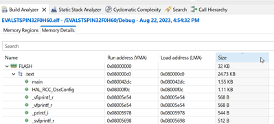

I compile EVALSTSPIN32F0H60 example using STM32CubeIde and following setup to save space on flash/ram:
  • On linker file size are:
/* Entry Point */
ENTRY(Reset_Handler)
/* Highest address of the user mode stack */
_estack = ORIGIN(RAM) + LENGTH(RAM); /* end of "RAM" Ram type memory */
_Min_Heap_Size = 0x200; /* required amount of heap */
_Min_Stack_Size = 0x400; /* required amount of stack */
/* Memories definition */
MEMORY
RAM (xrw) : ORIGIN = 0x20000000, LENGTH = 4K
FLASH (rx) : ORIGIN = 0x8000000, LENGTH = 32K
  • On Tool Settings / MCU GCC Compiler / Debugging: Debug Level = None
  • On Tool Settings / MCU GCC Compiler / Optimization: Optimization Level = Optimize more (-O2)
This latest update is key to reduce RAM/FLASH size.

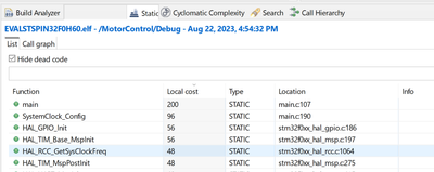

After this, check and locate the culprit using "Build Analyzer" / "Memory Details" / Flash and Ram tools.
It will help to understand where RAM/FLASH are used.

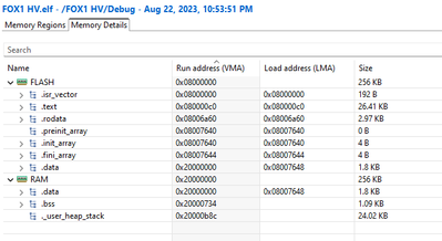

I tried with the below setting:
RAM (xrw) : ORIGIN = 0x20000000, LENGTH = 256K
FLASH (rx) : ORIGIN = 0x8000000, LENGTH = 256K
It compiled successfully, but I am still not able to figure out what needs to be changed?
I tried the below:
It compiled without errors. I am still not able to figure out what needs to be changed to get it right. Below is the screen shot of the bug analyser
