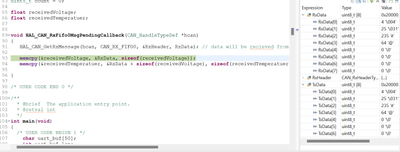

I am trying to convert floating point number to its byte representation to send through CAN Bus  HAL_CAN_AddMessage() and when I receive it I will convert back to its corresponding floating point number. I can convert the first floating point number to its byte representation and when I receive it back by the HAL_CAN_GetMessage() I convert it back to its floating point number. The first floating point number works fine. The problem occurs when I try to do the second one. I do not receive anything for the second one.
assume that the floating point variable are:
float voltage = 7.3789;    I got this value by reading a register with 16bits and 2 bytes
float temperature 21.98290;  I got this value by reading a register with 16bits and 2 bytes
the first memcpy() works fine
this is the entire code:
uint32_t TxMailbox[3];    //create a variable Mailbox to transmit data
uint8_t TxData[8];    // buffer for transmit data
uint8_t RxData[8];    // buffer for recieving data
uint8_t count = 0;
float receivedVoltage;
float receivedTemperatuer;
void HAL_CAN_RxFifo0MsgPendingCallback(CAN_HandleTypeDef *hcan)
   HAL_CAN_GetRxMessage(hcan, CAN_RX_FIFO0, &RxHeader, RxData); // data will be recieved from CAN_RX_FIFO0, the header will be stored in RxHeader, data will be saved in RxData
   memcpy(&receivedVoltage, &RxData, sizeof(receivedVoltage));
   memcpy(&receivedTemperatuer, &RxData + sizeof(receivedVoltage), sizeof(receivedTemperatuer));

  void SendFloatsOverCAN( float voltageVal, float temperatureVal){
  memcpy(&TxData, &voltageVal, sizeof(voltageVal));
  memcpy(&TxData + sizeof(voltageVal), &temperatureVal, sizeof(temperatureVal));
  HAL_CAN_AddTxMessage(&hcan2, &TxHeader, TxData, TxMailbox);

the same data is in RxData and TxData

That the TxData buffer has the last 4 bytes as zero isn't exactly convincing that the data passed into SendFloatsOverCAN() are correct.
Print them out there, confirm they are as expected and temperature != 0
floats are 4 bytes, not 2, show this, the value and the computation, I'm not convinced.
Karl Yamashita
Principal
Just send the two values, Voltage and Current as the register values. Then the receiving node will convert the bytes to float values.
