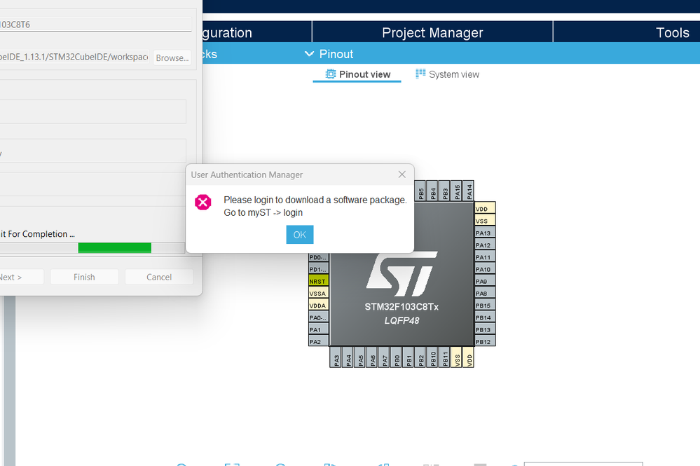

even after logging in, I get the error pls login to download software package. what am i missing?
2023-08-18 4:11 AM
here is the pic , how to login successfully so that I can download packages and work with the code ide software efficiently?
2023-08-18 5:45 AM
Hello @KANISHK
Could you please try to follow those steps then provide the STM32CubeMX.log:
- Delete user/.Stm32CubeMx
- Run STM32CubeMx 6.9.1
-Click on MyST-->login
-Click on Help -->Updater settings -->Connection parameters --> then check your connection
I will be waiting for your feedback.
Thx
Ghofrane
