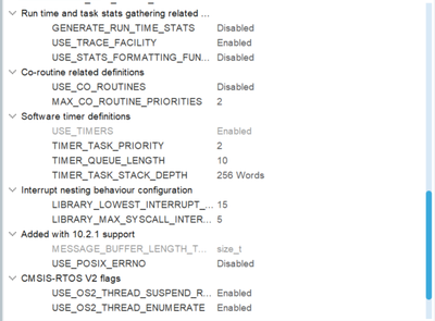

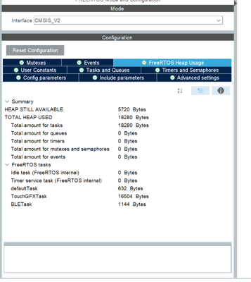

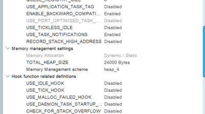

I've included the task initialization and process for both below. Additionally, I've attached my CubeMX configuration for the FreeRTOS system.

I am unfamiliar with FreeRTOS on a deep level, but I suspect it is related to memory management and/or the priority system of the tasks, but I am unsure of how to prove this and diagnose this problem. The reason I suspect it's a memory issue though is that I'm running at 94.61% of Internal RAM usage. I allocate the entire TouchGFX task and 480x272, RGB565 array in the Internal RAM, which is why it's so heavily used.
