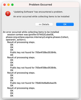

Hi, I am trying to update my STM32Cube to the latest version using Help > Check for Updates, the update fails with the following error:
Trying to update Cube V1.9.0 to the latest, running OSX 13.0. How do I fix this?
I found another thread which suggest a complete uinstall / reinstall is the solution, but I really don't want to do that as this is my main work computer and any downtime would have a huge negative impact on the projects I am working on.
Please advise.

This is the complete text of the error for reference:
An error occurred while collecting items to be installed
session context was:(profile=STM32CubeIDE, phase=org.eclipse.equinox.internal.p2.engine.phases.Collect, operand=, action=).

I do not EVER allow CubeIDE or CubeMX to auto update. NEVER. Instead, I install multiple versions along side each other. For production code you need a well defined and repeatable development environment. Auto-update interferes with that.
So leave your CubeIDE 1.9.0 install alone. Download and install 1.13.x into a separate directory and you will be able to run either one.
‎2023-11-13 2:58 PM
Seems like a good call, I will try doing it that way
