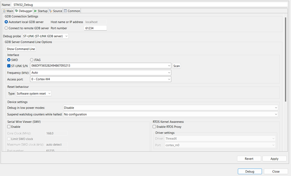

Hello Sir,
I'm new to this STM 32 environment. I'm using Nucleo F429ZI board when I try to debug the board it shows the following error.
"Error in final launch sequence:
Failed to execute MI command:
target remote localhost:61234
Error message from debugger back end:
localhost:61234: Connection timed out.
localhost:61234: Connection timed out."
Please help me to solve the issue.

Hello @MA and welcome to the community,
Could you, please, provide the debug configuration for this board and attach the GDB server log file to further analyze the issue.

‎2023-08-16 5:02 AM
Hello Madam,
Please find the attached debug configuration and the log file for your reference.
‎2023-08-21 3:29 AM
Could you connect the target to STM32CubeProgrammer . If it is connected successfully , try to:
- Erase the Flash with STM32CubeProgrammer
- Disconnect STM32CubeProgrammer from the target
- Debug the program using ST-LINK_gdbserver
