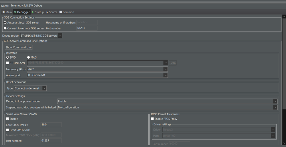

‎2023-01-30 1:27 AM
Hello @jreis.1​
Could you share the debug configuration as well as the complete debug log to give a clearer view about the issue.
Thanks,
Semer.

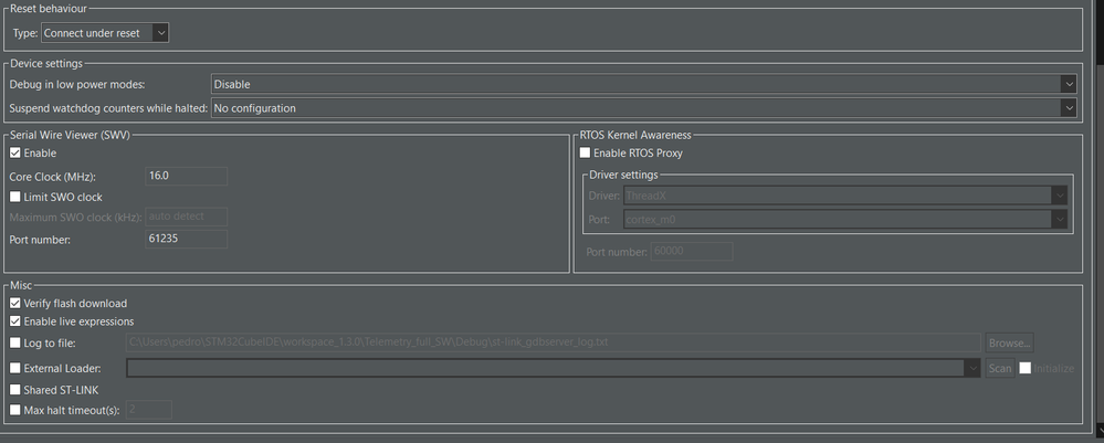

‎2023-01-31 2:46 PM
Hi! Here it is the debug configuration. How can i get the debug log? Thanks in advance!

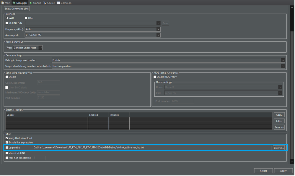

‎2023-02-01 7:18 AM
Hello @jreis.1​
My bad I should have put a description on how to get the debug log.
Under the debug configuration -> Debugger check the log to file option as shown in the screenshots:
