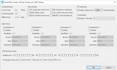

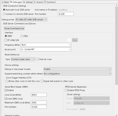

Once you compile and run the debug, activate the SWO and limit the frequency at 2MHz (otherwise it will run at 12)

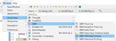

After the program is loaded and the execution stops at the beginning of the main, add the toolbar for the SWV ITM Data Console:
and add the port 0 on the settings:
then press the "Start Trace" button before resuming the code execution:

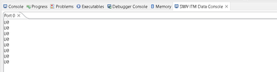

At this point you will see the output:

P.S. The ST-Link V3 can work also at 12MHz, as I set-up in the project in attach. You will need to remove the tick "Limit SWO clock" in the debugger configuration and change to 12000 the variable SWOSpeed into the main.c.

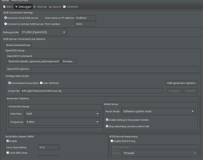

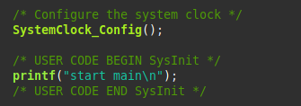

    AScha.3
    June 22, 2023
    well, i tried "your way" ... just get nothing than >hard fault. (on F303 cpu )
    on cubeIDE
    then removed some lines...then all.
    nothing from itm.
    using open ocd :
    so removed all , again set only:
    /* USER CODE BEGIN 4 */
    int __io_putchar(int ch)
     ITM_SendChar(ch);
     return (ch);
    with:
    then it worked...
    try it. (but i can promise, it is more hit and hope game ! )

    AScha.3
    March 26, 2025
    no.
    Tested and working on H5 (563), H7 (733, 743, 7A3) :
    I have just enabled SWD+SWo in Cube, then in debug settings also: enable SWV . + set correct core frequemcy, it will run.
    Then in main, just the
     ITM_SendChar(ch);
     return (ch);
    In debug session then, pause, select SWV, ...as you show it on top. + "start trace" .
    Then its working, thats all.
