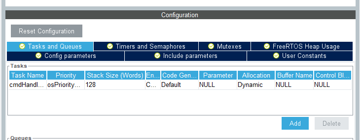

When I use CMSIS RTOS I set a stack size of 128 words. Then the following code is generated:
 /* Create the thread(s) */
 /* definition and creation of cmdHandlerTask */
 const osThreadAttr_t cmdHandlerTask_attributes = {
  .name = "cmdHandlerTask",
  .priority = (osPriority_t) osPriorityNormal,
  .stack_size = 128
 cmdHandlerTaskHandle = osThreadNew(CmdHandlerTask, NULL, &cmdHandlerTask_attributes);
When I read the documentation, the stack size in osThreadAttr_t is in bytes and the code seems to confirm this. Is this a bug or have I misunderstood it? (Im new to stm32 and this kind of low level programming so Im not too confident that I understood things right.)
Can someone confirm or disprove my suspicion?

AGarp.1
It is explicitly stated so in the CubeMX IDE that the stack size is in words. And the heap usage calculator seems to use that info.0690X00000BuxvbQAB.png

Im using CMSIS API v2 which is using FreeRTOS as backend. But what seem to be the issue is the Cube code autogenerator.
Dmytro Kovalenko
I agree with topic starter. When selected CMSISv2 - then Cube "say Words", but code generated in bytes. As result stack overflow for default task mostly guaranteed.
