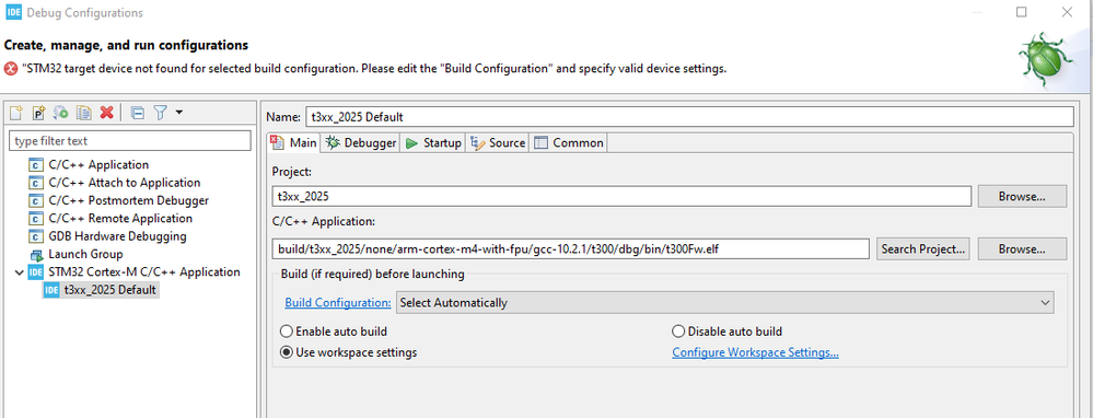

I imported the whole project structure as a "makefile project". By doing so I can actually build this cmake project within STM32CubeIDE.
Now the problems arise when I try to create a debug config.
STM32CubeIDE always tells the that no target device was found.
How can I tell the debugger that the target is an STM32F429?

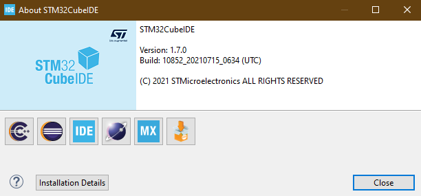

Hey I'm already running 1.7.0.
Is 1.7.0 helpful to you ?

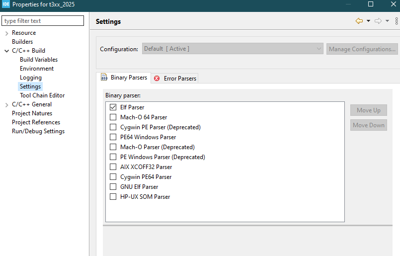

0693W00000D0EfLQAV.pngHey thx for your answers.
The tab "MCU" is not available from this CMake project (can i somehow enable it)
I'll try to test your second suggestion File > Import > C/C++ > STM32 CortexM executable and provide feedback. :)
