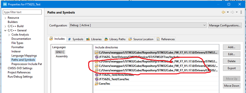

Current STM32Cube IDE always install STM32Cube repository to the Windows 10 user folder. How can I install the repository to a different location or move or copy to workspace so the project properties can be shared with other developers?
GWang.6
Here is a screen shot for repository include paths.

WQ
Window->Preferences->STM32Cube->Firmware Updater...
Foued_KH
Hello @GWang.6​ ,
In STM32CubeIDE, look at the menu bar at the top, and go to WindowPreferencesSTM32CubeFirmware Updater. In the upper portion of the window you should find a field named Firmware installation repository.
