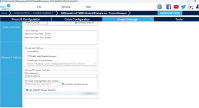

hello i downdload latest version but again this error will come when i press migrate or continue option after that iam updating my code in this code  goes to  error part. fix this problem.

@syedhashmiraza wrote:
yes i tried this one but still code not working
Share again the screenshot with that option.
And again check if you have C:/Users/Ciright/STM32Cube/Repository/STM32Cube_FW_F4_V1.28.1on your local disk drive --> please confirm that
iam facing same problem
After checking that option, did you regenerate the code and click on "Migrate"?
yes i did this but still error will come after  i genrate code

Hello @syedhashmiraza
Let's try this:
- Close the CubeMX.
- Go to C:\Users\XXXX    and delete .stm32cubemx
- Then Reopen the CubeMX 6.13.0 load your IOC.
THX
Ghofrane
mbarg.1
Senior III
This is NOT an ERROR.
It is a SWITCH between 2 options.
In xx.ioc editor,  project manager tab, check if "Use latest version" is checked.
If checked, every time you start edit an .ioc you can decide between 2 options, old version or new version
