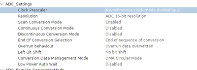

CubeMX ADC_Settings/Clock PreScaler setting does not show up in MX_ADCx_Init Code
STM32CubeMX - STM32 Device Configuration Tool
Version: 6.10.0-RC9
Build: 20231120-2037 (UTC)
 Unless I cannot see the forest for the trees, the prescale setting is not there.

So I added to the user section like so:
static void MX_ADC3_Init(void)
 /* USER CODE BEGIN ADC3_Init 0 */
 /* USER CODE END ADC3_Init 0 */
 ADC_ChannelConfTypeDef sConfig = {0};
 /* USER CODE BEGIN ADC3_Init 1 */
 hadc3.Init.ClockPrescaler = ADC_CLOCK_ASYNC_DIV2;
 /* USER CODE END ADC3_Init 1 */
Does it show up somewhere else?
Or is this a bug in the CubeMX code?

Issue fixed in the latest version of CubeMx 6.12.0

You need to provide the MCU part number or at least attach the ioc file.
Why are you not using the latest version 6.11?

STM32H743
I am in the middle of development and as a rule I never jump to a new revision of the tools unless I am specifically fixing something in the current project where the current tool is the problem.

Need to check and get back to you as soon as possible.
Internal ticket 178907 not accessible by community users.
