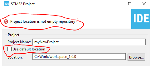

@Cartu38 OpenDev​ comment about issue analysis is fully valid.
Obviously we are monitoring closely community feedback. Relying on we are committed to improve tools release after release.
Next STM32CubeIDE release will be delivered soon and will bring some extra project location sanity check helping end user experience preventing to face such bad situation.
Starting coming release we are going to prevent end user to ask for project creation if promoted location already host some material.
