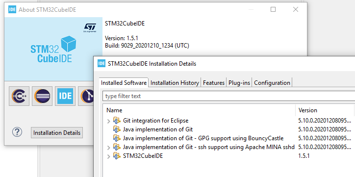

I'm trying to add GIT source control but it seems there is no way. I tried to install the EGit plugin with catastrophic results, i see there is under properties, team a git menu but there is no way apparently for me to add git functionalities.
Ho do GIT is working under CubeIDE?

Hi Filippo,
How did you manage to install eGit?
The recommenced way is to use the Eclipse Marketplace from Help menu.
Here is what I have in Help > About > Installation Details once installed:
0693W000007CSxDQAW.pngThen it's pretty simple to use, but way of working differs depending if you want to clone and existing repository (Import > Git > Project from Git) or start from scratch using a local repository (Team > Share).
All is already well described in eGit user guide (https://wiki.eclipse.org/EGit/User_Guide).
