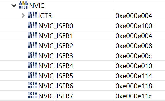

[CubeIDE BUG] NVIC_ISER1-NVIC_ISER4 have wrong addresses at SFR view for NUCLEO F411RE
‎2021-01-18 1:59 PM
Using the Cortex-M4 Devices Generic User Guide at page 219 it is written the address of ISERs
0xE000E100- 0xE000E11C NVIC_ISER0- NVIC_ISER7
While I was trying to debug my program I realized that these addresses in the IDE are wrong as you can see in the picture
I hope that bug could be confirmed and fixed
If there is another place that I can post it please direct me to that.
STM32CubeIDE Version: 1.5.1 Build: 9029_20201210_1234 (UTC) Windows 10

‎2021-10-08 4:25 AM
This issue should be fixed in CubeIDE 1.7.0.
ST Internal ticket reference 109845.
‎2021-04-01 11:28 PM
I have the same problem with Version: 1.6.1, Build: 9958_20210326_1446 (UTC)
