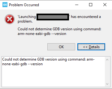

I am using CubeIDE version 1.16.1 to program and flash a STM32F433 MCU.
I am using a SEGGER J-Link flasher.

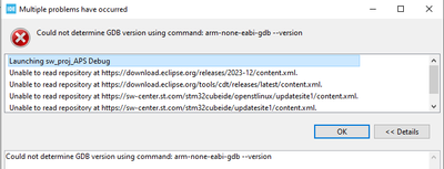

When I try to run the application I get the following error:

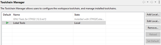

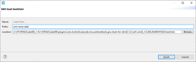

I have tried to manually set the workspace toolchain to local in the toolchain manager.

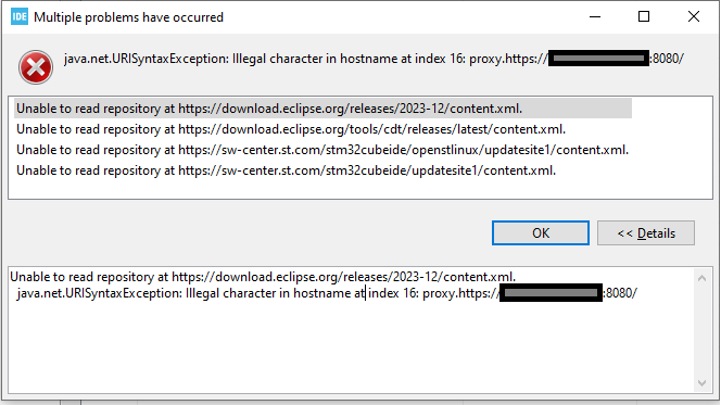

When I open the toolchain manager, I get an error that it has failed to fetch the toolchain list, in addition to four repositories that it cannot read:
Ignoring the message and setting the local toolchain as it follows
I get the same error when running the code on the MCU:
What should I try to do to fix the error?

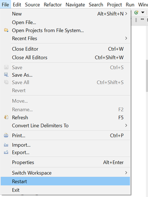

Also Clear Cache:
Sometimes, cache issues can cause problems. Try clearing the cache in CubeIDE by going to File -> Restart

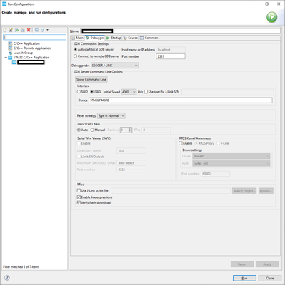

Here my debugger settings:
*my MCU STM32F446

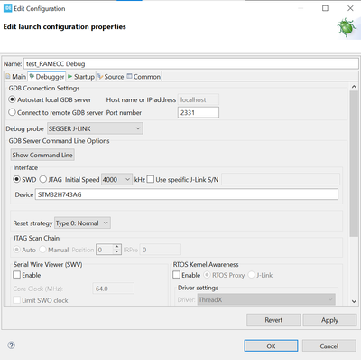

Hello again @Uloff.4
1- First let's try to use the SWD (Serial Wire Debug) interface for debugging purposes. Segger J-Link devices support both SWD and JTAG (Joint Test Action Group) interfaces for debugging ARM Cortex-based microcontrollers but using SWD with a Segger J-Link offers a reliable and efficient way to debug your target device.
2- Click on "Show command line," copy the command, open your command prompt, paste it there. Before proceeding, ensure that your J-Link is connected and your board is ready. Finally, share the log, please.
THX
Ghofrane
‎2024-10-03 6:53 AM
Using SWD with the SEGGER gives the same error.

‎2024-10-09 11:36 PM - edited ‎2024-10-10 12:39 AM
Hello Ghofrane
I have installed the Arm GNU Toolchain for Windows:
gcc-arm-none-eabi-10.3-2021.10-win32.exe
I have added the path to the environment variables (admin+user) as follows:
Now I can call the function from the cmd line (user), but when I ask for the version number nothing happens, it gives no response and stays there:
When I try to run the code in STM32CubeIDE (user) I get the same errors:

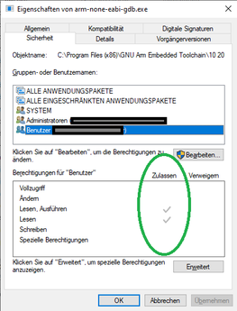

I tried then to run the command via admin cmd and got the following:
Here are the user permissions for the file:
Thank you for your help.
‎2024-10-10 12:41 AM
Hello @Uloff.4
The error message you are encountering indicates an issue with IDE's ability to access or read the repository at https://download.eclipse.org/tools/cdt/releases/latest/content.xml. This problem could be due to various reasons, such as network issues.
1- Check Network Connection:
Ensure that your internet connection is stable and that there are no network issues preventing STM32CubeIDE from accessing external repositories.
2- Proxy Settings:
If you are behind a corporate firewall or using a proxy server, configure the proxy settings in STM32CubeIDE to allow it to access external repositories.
3- Firewall/Antivirus:
Check if any firewall or antivirus software on your system is blocking STM32CubeIDE from accessing external repositories. Temporarily disabling them can help identify if they are causing the issue.
4- Test with Full Path:
Try running the arm-none-eabi-gdb command with the full path to the executable to see if it provides the version information. For example, C:\path\to\arm-none-eabi-gdb.exe --version.

‎2024-10-11 12:03 AM - edited ‎2024-10-11 12:13 AM
Hello @Ghofrane GSOURI

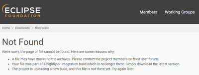

When I click on the link you mentioned, it says "not found".
I have proxy settings setup in STM32Cube IDE and I can prove they work in the settings with the check connection button:

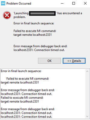

As seen the admin account is able to use GDB, so i tried to launch STM32IDE as admin and tried to launch debug with the SEGGER J-link. Then i got the following error:
