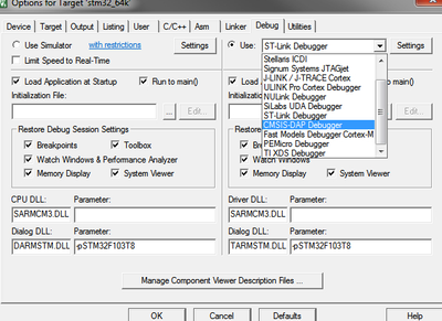

i think, STM dont want the "standard" , open source Cmsis-DAP to be used on the Eclipse - STM - IDE .
Dont ask me why , ask STM.
Or use Keil IDE, ...

here's why I don't wanna use keil: I just want to be familiar with what I started working in:CubeIDE, so that I can just easily start using the st link once I buy it (In maybe like 3-6 months)

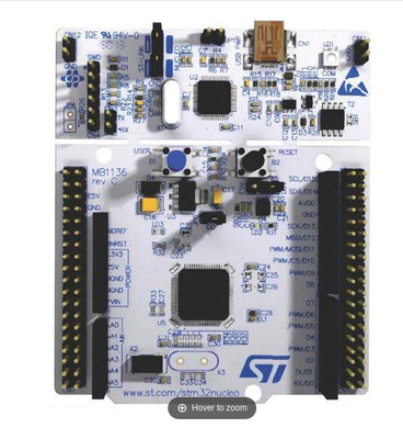

To have something, to connect - and it works : buy a cheap nucleo board (with onboard st-link).
https://www.mouser.de/c/embedded-solutions/engineering-tools/embedded-processor-development-kits/development-boards-kits-arm/?q=nucleo
If you take a board like this:
https://www.mouser.de/ProductDetail/STMicroelectronics/NUCLEO-F303RE?qs=ClYTdQWm4hA0O%2FMhBC5%2FXg%3D%3D
you can even use the st-link separate , not only for this board.
