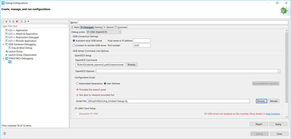

I need to manually edit the debugging configuration script (CFG) file in STM32CubeIDE. But I can't seem to make CubeIDE run with a user-generated file or make any modifications to the auto-generated file.
- I provided CubeIUE with a path to a user-generated CFG file.
- For the purposes of the test, I used one that is identical to the auto-generated file except for a marker comment at line 12.
- When I attempt to launch debugging, CubeIDE overwrites the user CFG with a new auto-generated CFG.
- It will then try to debug with the new auto-generated CFG. This fails because my debugger needs custom settings.
- When I reopen the debugger configuration settings, CubeIDE shows two errors:
- Provided file doesn't exist!
- Not able to interpret provided file!
- This is ridiculous because the user CFG:
- Exists right in the project directory, in the IDENTICAL LOCATION to where auto-generated CFGs are placed. I have also tried other locations.
- Is IDENTICAL to the auto-generated CFG except for a marking comment.

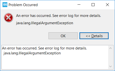

- A Java error is also produced, but no details are provided.
Is there any way to actually use custom debugger CFG files, or is this option just not functional in CubeIDE?
