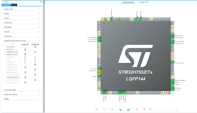

I am trying to do this tutorial: https://community.st.com/t5/stm32-mcus/how-to-implement-the-usb-device-composite-class-in-stm32-using/ta-p/645017 but I can't find Azure RTOS in Middleware and software Packs. I have already downloaded the packs for azure H7 and placeit here ( C:\Users\XXXXX\STM32Cube\Repository\Packs\STMicroelectronics) but nothing in CudeIDE.
Is enybody have an idea how I can do
Thanks,
G.

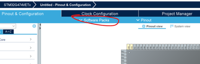

It can be found within the "Software Packs" tab.

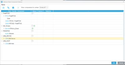

Gwen1
I have only this...
And I can't open Manage software packs.

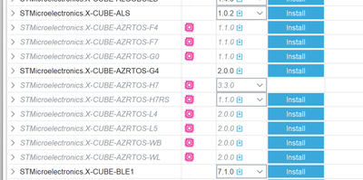

Are you using STM32CubeMX or STM32CubeIDE? And what version? Make sure it's updated.
Gwen1
I am using CubeIDE version 1.13.2 and I can't upgrade to an other version because of the firewall.
Is my path to the folder is correct ?
In Repository:
/Packs/STMicroelectronics
For information I manually create the path.
I'm not sure manually copying the files is having the same effect as installing them via the program.
I would guess upgrading the version would solve these issues.
Gwen1
As I say before I can't upgrade my version. But thanks for your help.
This is a very old version of CubeIDE. Need to request to your IT team to allow you to do the updates.
Thanks for your help, IT team can't do that so I use the newest version to another PC and it works.
