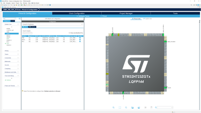

Start by creating a project for the STM32H723ZGT6 in the STM32CubeIDE and enabling the following:
  • PB0 (LD1 green LED)
  • PE1 (LD2 yellow LED)
  • PB14 (LD3 red LED)
    As GPIO output push-pull to get access to the LEDs available on the board.
Fig 2. STM32CubeMX - GPIO SettingsFig 2. STM32CubeMX - GPIO Settings

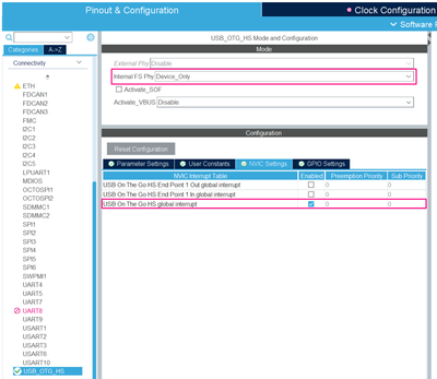

Navigate to the USB_OTG_HS menu under the "Connectivity" tab. Once opened, navigate to the "USB Peripheral" tab, select the “Device_Only” option in the “Internal FS Phy.” Afterwards, enable the “USB On the Go HS” global interrupt under the "NVIC Settings" tab. By doing so, the "Clock Settings" tab signalize an error. but don’t worry, we will correct it in the next step.
Fig 3. STM32CubeMX - USB SettingsFig 3. STM32CubeMX - USB Settings

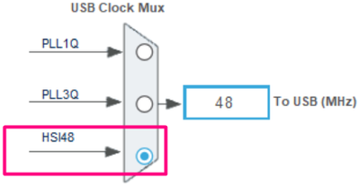

Go to the "Clock Configuration" tab, increase the frequency of HCLK frequency and the most important thing, change the USB clock mux source to the HSI48.
Fig 4. STM32CubeMX - Clock Settings for USBFig 4. STM32CubeMX - Clock Settings for USB

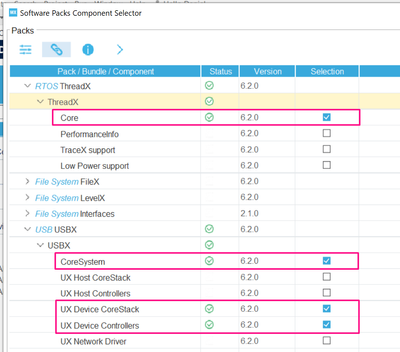

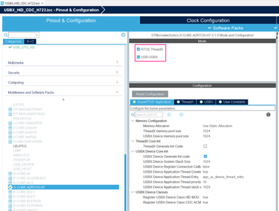

After doing that, go back to the “Pinout & Configuration” tab and under the "Middleware and Software Packs" menu, click on the X-CUBE-AZRTOS-H7. It opens the "Software Packs Component Selector." Then enable the following required components:
  • RTOS ThreadX -> ThreadX -> Core
  • USB USBX -> USBX -> CoreSystem
  • USB USBX -> USBX -> UX Device CoreStack
  • USB USBX -> USBX -> UX Device Controller
Fig 5. STM32CubeMX - X-CUBE-AZRTOS-H7, ThreadX and USBX settingsFig 5. STM32CubeMX - X-CUBE-AZRTOS-H7, ThreadX and USBX settings
We enabled the RTOS ThreadX since the USBX was developed to run with the Azure RTOS. It is possible to run the firmware in standalone mode, as covered in this other article How to implement USBX in standalone mode - STMicroelectronics Community.
In the USBX, we enabled the CoreSystem and UX Device CoreStack, which contains the middle layer firmware for the USB in device mode that ensures the USB stack processing. Furthermore, the interface between the low and high layers. Lastly, the UX device controllers, low layer firmware to interface with the hardware USB peripheral.

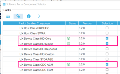

Finally, add the class components of your application. For this example, we use the HID mouse and the CDC ACM classes:
  • USB USBX -> USBX -> UX Device HID Core
  • USB USBX -> USBX -> UX Device HID Mouse
  • USB USBX -> USBX -> UX Device CDC ACM
Fig 6. STM32CubeMX - X-CUBE-AZRTOS-H7, USBX Classes settingsFig 6. STM32CubeMX - X-CUBE-AZRTOS-H7, USBX Classes settings

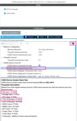

In the next step, we need to increase the amount of memory allocated for the USBX Device System Stack Size. To define this amount of data, refer to the information block to see the necessary memory for each class. Since we are using two classes in this example (the HID and CDC ACM), the amount of memory is the sum of those.
Fig 8. STM32CubeMX - X-CUBE-AZRTOS-H7, USBX stackFig 8. STM32CubeMX - X-CUBE-AZRTOS-H7, USBX stack

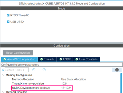

Then increase the USBX device memory pool size. This memory pool should be adjusted to fit the "USBX Device System Stack Size" and the thread stacks that are used in the USBX application. You can select whether the threads are in the ThreadX or in the USBX memory pool. In this example, we create three threads with 1 KB of stack. So, we use 10KB (USBX Device Stack Size) + 3KB (Threads stack) + 2KB (for other components) = 15 KB.
Fig 9. STM32CubeMX - X-CUBE-AZRTOS-H7, memory poolFig 9. STM32CubeMX - X-CUBE-AZRTOS-H7, memory pool

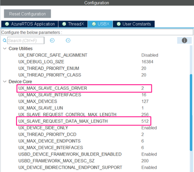

The next changes will be made in the USBX tab. There, increase the UX_MAX_SLAVE_CLASS_DRIVER to 2, since we are using 2 classes, then decrease the UX_SLAVE_REQUEST_DATA_MAX_LENGTH to 512.
Fig 10. STM32CubeMX - X-CUBE-AZRTOS-H7, USBX Class settingsFig 10. STM32CubeMX - X-CUBE-AZRTOS-H7, USBX Class settings

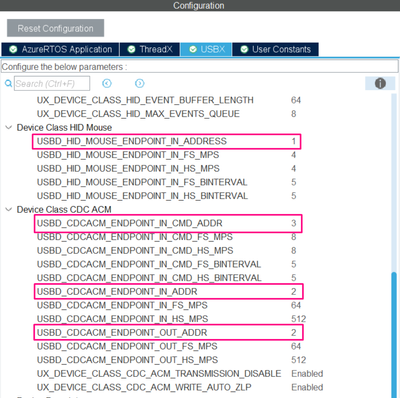

Scroll the menu down and select the Endpoints for the HID and for the CDC ACM. Here, the 0x81 EP IN is used for the HID mouse. The 0x02 EP OUT for the CDC ACM out. The 0x82 EP IN for the CDC ACM in and finally the 0x83 EP IN for the CDC ACM command in.
Fig 11. STM32CubeMX - X-CUBE-AZRTOS-H7, USBX Endpoint settingsFig 11. STM32CubeMX - X-CUBE-AZRTOS-H7, USBX Endpoint settings

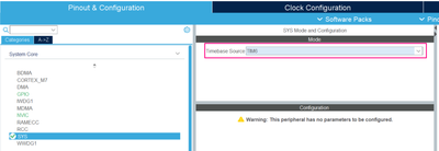

Since we are using an RTOS, we cannot use the Sys_Tick for the HAL timebase, as this timer is used by it. Go to "System Core", then "SYS" and change the timebase for any basic timer, such as TIM6.
Fig 12. STM32CubeMX - Timebase SourceFig 12. STM32CubeMX - Timebase Source

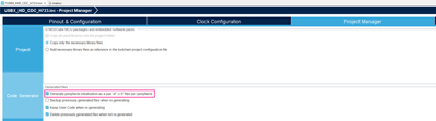

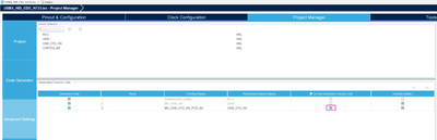

Now, go to the "Project Manager" tab and in the "Code Generator" section enable the “Generate peripheral initialization as pair of ‘.c/.h’ files per peripheral”. This facilitates the access to the peripheral resources in the code.
Fig 13. STM32CubeMX - Code generation settingsFig 13. STM32CubeMX - Code generation settings
The last step before generating the code is to disable the USB_OTG_HS peripheral initialization code in the advanced settings also found in the "Project Manager" tab.
Fig 14. STM32CubeMX - Code generation advanced settingsFig 14. STM32CubeMX - Code generation advanced settings
Now, that all the settings are done you can generate the code. For that you can use the alt + K shortcut or press the generate button.

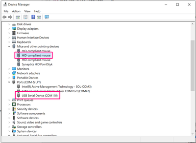

 Doing that you have all set for using the USBX. If you build and program this code, and then connect a USB cable in the board’s user USB connector, it should enumerate and present two classes: A CDC and an HID.
Fig 15. Windows Device Manager - USB EnumerationFig 15. Windows Device Manager - USB Enumeration

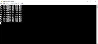

 Finally, we can create our CDC ACM threads to transmit and receive data:
/* USER CODE BEGIN 1 */
VOID usbx_cdc_read_thread_entry(ULONG thread_input)
 /* Local Variables */
 ULONG actual_length;
 UX_SLAVE_DEVICE *device;
 device = &_ux_system_slave->ux_system_slave_device;
 /* Infinite Loop */
 while(1)
 /* Check if device is configured */
 if((device->ux_slave_device_state == UX_DEVICE_CONFIGURED) && (cdc_acm != UX_NULL))
 ux_device_class_cdc_acm_read(cdc_acm, (UCHAR *)UserRxBuffer, 16, &actual_length);
 for(uint8_t i = 0; i < actual_length; i++)
 switch(UserRxBuffer[i])
 case '1':
 HAL_GPIO_WritePin(LD2_YELLOW_GPIO_Port, LD2_YELLOW_Pin, GPIO_PIN_SET);
 break;
 case '0':
 HAL_GPIO_WritePin(LD2_YELLOW_GPIO_Port, LD2_YELLOW_Pin, GPIO_PIN_RESET);
 break;
 /* Sleep for 10ms */
 tx_thread_sleep(1);
VOID usbx_cdc_write_thread_entry(ULONG thread_input)
 /* Infinite Loop */
 while(1)
 ux_device_class_cdc_acm_write(cdc_acm, (UCHAR *)UserTxMessage, sizeof(UserTxMessage), &actual_length);
 /* Sleep for 1s */
 tx_thread_sleep(100);
/* USER CODE END 1 */

3. Results
After flashing the code, connect a mini-USB cable into the user USB connector and connect it to the computer. Doing that, a USB composite device is enumerated with the two classes HID and CDC, as shown earlier.
Open a terminal to observe the message being transmitted every second via the VCOM port created. Additionally, sending the value 1 turns on the yellow LED, while sending the value 0 turns it off. Finally, pressing the user button moves the cursor diagonally to the bottom left of the screen.
Fig 16. Demo resultsFig 16. Demo results
