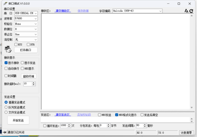

The Serial Port Assistant software is for printing text messages sent by F767 USART1, in another words, for displaying messages produced by printf() in App code:

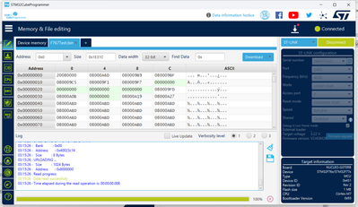

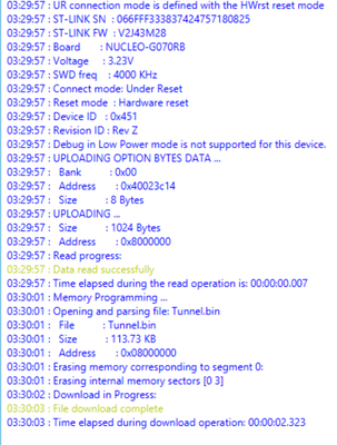

The complete messages for Connect and Download in CubeProgrammer:

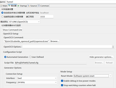

Follow your suggestion, set the following:

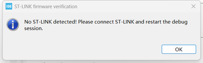

then click on Apply and Debug buttons, I got the following message:
This should be because the Programmer is still connected, so disconnect in Programmer, repeat the above process again, but the debugger is still not launched.

btw. 24MHz connection is for st-linkV3 , V2 works at 4 M .
but no link detected - is strange. Because in CubeProgrammer link (  nucleo G070 ) is detected.
Sorry, but this is nothing i ever seen... try unplug and re-plug the st-link or nucleo board, you use as link;
then start debug in IDE again.
Sometimes  its helping: set debug back to GDB , try again debug.
