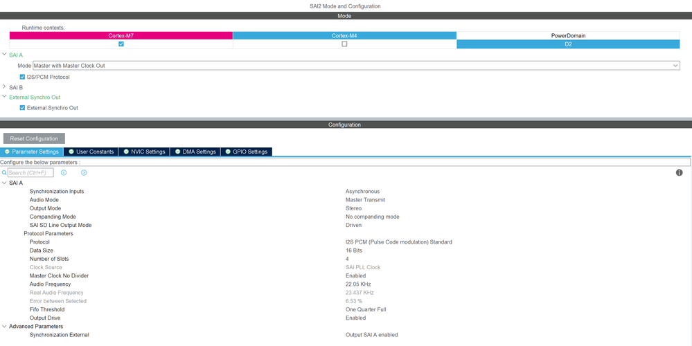

Can't make WM8994 play over SAI on STM32H745I-DISCO board.
HTD
Senior III
My project uses HAL and it's made with STM32CubeIDE.
I've naturally seen the example and tried to configure everything exactly as in the example.
So - the clock for SAI is set to 4.096MHz. I use SAI1 configured as on the screen:
0693W00000WLEAFQA5.png0693W00000WLEAKQA5.png0693W00000WLEAPQA5.pngHere's my code:

OK, now the generated code:
static void MX_SAI1_Init(void)
  /* USER CODE BEGIN SAI1_Init 0 */
  /* USER CODE END SAI1_Init 0 */
  /* USER CODE BEGIN SAI1_Init 1 */
  /* USER CODE END SAI1_Init 1 */
  hsai_BlockA1.Instance = SAI1_Block_A;
  hsai_BlockA1.Init.AudioMode = SAI_MODEMASTER_TX;
  hsai_BlockA1.Init.Synchro = SAI_ASYNCHRONOUS;
  hsai_BlockA1.Init.OutputDrive = SAI_OUTPUTDRIVE_ENABLE;
  hsai_BlockA1.Init.NoDivider = SAI_MASTERDIVIDER_ENABLE;
  hsai_BlockA1.Init.FIFOThreshold = SAI_FIFOTHRESHOLD_1QF;
  hsai_BlockA1.Init.AudioFrequency = SAI_AUDIO_FREQUENCY_22K;
  hsai_BlockA1.Init.SynchroExt = SAI_SYNCEXT_DISABLE;
  hsai_BlockA1.Init.MonoStereoMode = SAI_STEREOMODE;
  hsai_BlockA1.Init.CompandingMode = SAI_NOCOMPANDING;
  hsai_BlockA1.Init.TriState = SAI_OUTPUT_NOTRELEASED;
  if (HAL_SAI_InitProtocol(&hsai_BlockA1, SAI_PCM_SHORT, SAI_PROTOCOL_DATASIZE_16BIT, 4) != HAL_OK)
    Error_Handler();

Now wait a minute, I have SAI1 in example, but the board schematics says otherwise:
0693W00000WLEpSQAX.pngI tested it with SAI2, but still, the same, doesn't work.
19 REPLIES 19
AScha.3
make new project and try the original example first.
HTD
Senior III
Yes. I set it that way. Still doesn't work. My current Cube configuration:
The original example doesn't show how to use audio on STM32CubeIDE project. The problem is I have big existing project I just need to add a simple beep feature. I've analyzed most of the differences between those two projects and tried to copy everything I could from the original.
My question is how to exactly do beep on STM32H745I-DISCO without starting a new project in Embedded Wizard.
