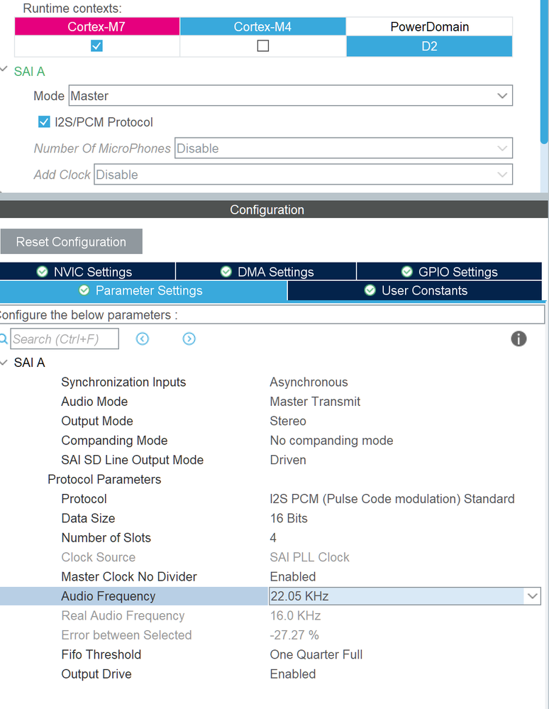

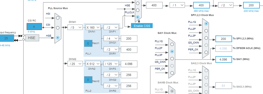

So - the clock for SAI is set to 4.096MHz. I use SAI1 configured as on the screen:
0693W00000WLEAFQA5.png0693W00000WLEAKQA5.png0693W00000WLEAPQA5.pngHere's my code:

OK, now the generated code:
static void MX_SAI1_Init(void)
  /* USER CODE BEGIN SAI1_Init 0 */
  /* USER CODE END SAI1_Init 0 */
  /* USER CODE BEGIN SAI1_Init 1 */
  /* USER CODE END SAI1_Init 1 */
  hsai_BlockA1.Instance = SAI1_Block_A;
  hsai_BlockA1.Init.AudioMode = SAI_MODEMASTER_TX;
  hsai_BlockA1.Init.Synchro = SAI_ASYNCHRONOUS;
  hsai_BlockA1.Init.OutputDrive = SAI_OUTPUTDRIVE_ENABLE;
  hsai_BlockA1.Init.NoDivider = SAI_MASTERDIVIDER_ENABLE;
  hsai_BlockA1.Init.FIFOThreshold = SAI_FIFOTHRESHOLD_1QF;
  hsai_BlockA1.Init.AudioFrequency = SAI_AUDIO_FREQUENCY_22K;
  hsai_BlockA1.Init.SynchroExt = SAI_SYNCEXT_DISABLE;
  hsai_BlockA1.Init.MonoStereoMode = SAI_STEREOMODE;
  hsai_BlockA1.Init.CompandingMode = SAI_NOCOMPANDING;
  hsai_BlockA1.Init.TriState = SAI_OUTPUT_NOTRELEASED;
  if (HAL_SAI_InitProtocol(&hsai_BlockA1, SAI_PCM_SHORT, SAI_PROTOCOL_DATASIZE_16BIT, 4) != HAL_OK)
    Error_Handler();

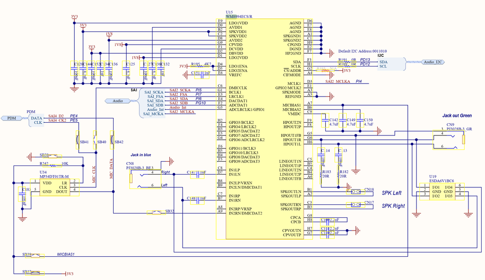

Now wait a minute, I have SAI1 in example, but the board schematics says otherwise:
0693W00000WLEpSQAX.pngI tested it with SAI2, but still, the same, doesn't work.

+ SAI clock is so slow - why ? ( i use 96 MHz sai module clock )

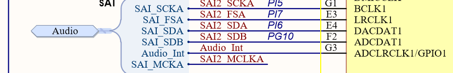

so : sai1 can never "work". :)
on sai2 - clkout A is set ? control the pin numbers, is every pin you use identical with board schematics?

I changed the configuration to SAI2 Block A. Pins match the schematics. Where can I set clkout A?

From what I see in the board schematics - the WM8994 is connected to SAI2 not SAI1:
0693W00000WLEuNQAX.pngBTW, in the main function of the example you have:
