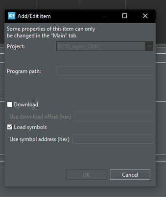

can not disable Download step in Cube IDE 1.16
ASche.5
the ok button stays gray and I need to disable download working on STM32H7 dual core poroject. in CubeIDE 1.12 this was working
yes that was it.
I had configured the debug, without a elf present. And without picking the elf that is connected to the build setting as it was not once created at this point. Confusing but ok.
So when you do this from scratch make sure to build a elf. So it can be found when creating the debug configuration as new.
Then the download can be prohibited to align multiple debug sessions on one target.

Souhaib MAZHOUD
Hello @ASche.5
Could you check that you have added the .elf file in Main.
I can't reproduce your issue using CubeIDE 1.16.0.
Thanx,
Souhaib
yes that was it.
