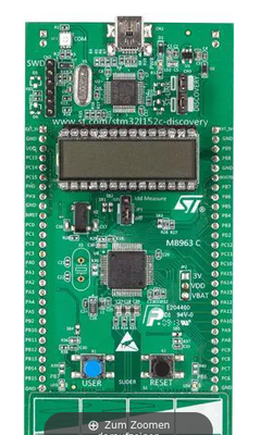

so buy a cheap disco board, to make some first programs and see them work (or not :) )
https://www.mouser.de/ProductDetail/STMicroelectronics/STM32L152C-DISCO?qs=OMTSpu7JCCvskXaoWbf3ow%3D%3D
12,38 €
