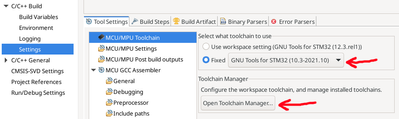

iforce2d
September 8, 2024
The accepted solution here is rather poorly described, I'm not sure if it is even the solution either. There is some in-depth discussion on SO which might be useful: https://stackoverflow.com/questions/73742774/gcc-arm-none-eabi-11-3-is-not-implemented-and-will-always-fail
Chances are if you had an existing project and this problem started when you upgraded CubeIDE, the most straightforward thing to do is tell CubeIDE to use the same toolchain as you had before, instead of the latest. You can do this under Project -> Settings -> C++ build -> Settings. First, use the toolchain manager to install the toolchain you want (most likely 10.3-2021.10 which seems to be the most recent one that avoids this problem). Then select 'fixed' and set that as the toolchain to use.
One thing I really would NOT recommend, is to ignore these warnings. I just wasted a whole day investigating why my bootloader would read 4 bytes from an external SPI flash memory but only 3 bytes actually got filled correctly. Those warnings seemed unrelated but I confirmed multiple times to my utter disbelief, that merely changing the toolchain was the problem.
In general, maybe this is a lesson to resist the urge to get the latest and newest of everything, and just focus on what actually matters, getting your product made, and not going insane from frustration.
