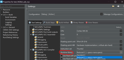

Might not be in the reduced C++ implementation. You can change to the standard implementation in project properties.

The setting is in project properties. This is for C. If you have C++ enabled, there will be a page for C++ as well.

Thanks TDK, but unfortunately switching it to standard c++ didn't make a difference. Still no std::thread and friends.
