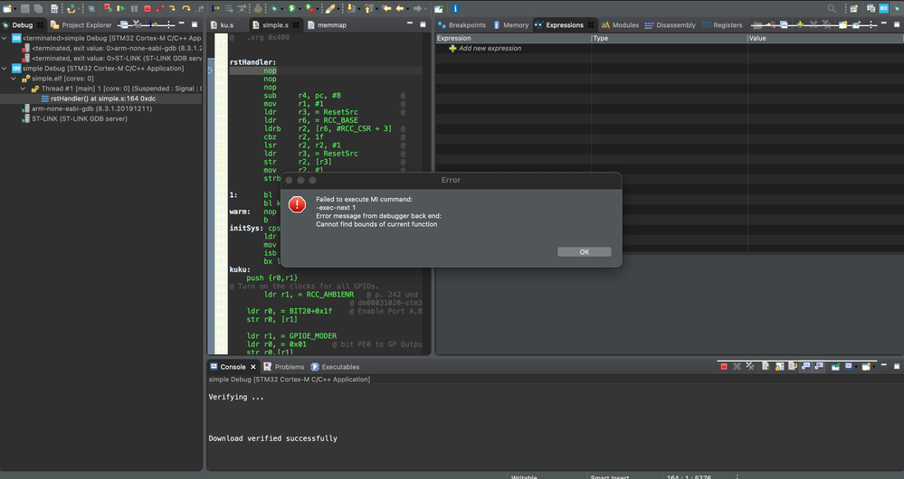

0693W00000BZaqlQAD.pngThanks Markus.
I unchecked Resume in the Debug Configuration Tab. The program stops at rstHandler (Reset vector location). There is no explicit BP set there.
But I cannot step from there on.

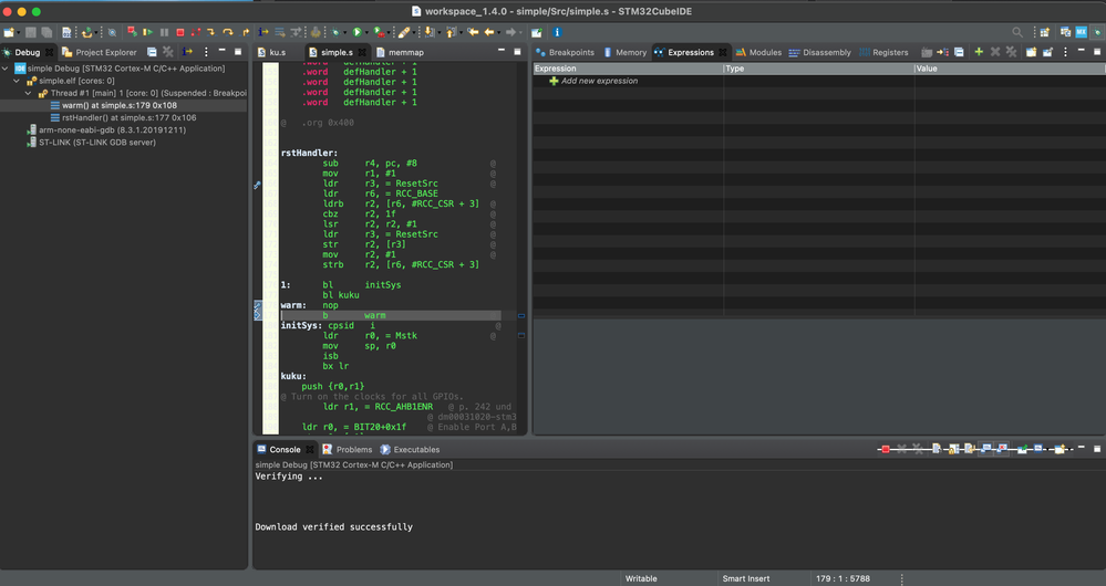

I reverted to "Resume" ticked on again.
This time the first breakpoint is hit right on. Setting then another breakpoint further down (see screenshot) at "warm: nop" you can see the BP arrow being one off.
So the problem persists.

Yes, I should have mentioned it in my OP. Indeed, when setting the BP in the disassembly view, it is set correctly and the arrow stops right on the set BP symbol.
Markus GIRDLAND
June 2, 2021
Thank you for the confirmation! I'll add the info to the ticket.
