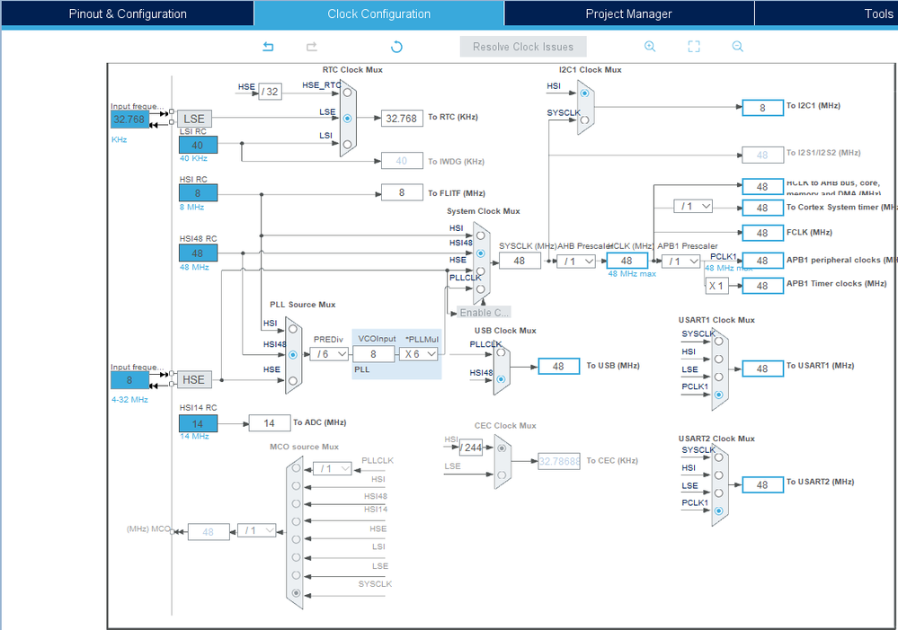

Hereafter the clock configuration:

Running code in the ROM
Make sure BOOT0 pin is held LOW​
