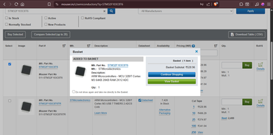

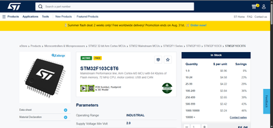

It would be really helpful if the fake STM32F103C8T6 didn't show up in the target selector in STM32CubeIDE
Also, it shows up on ST's website as a valid product: https://estore.st.com/en/stm32f103c8t6-cpn.html
Also, shows up on digiKey, Mouser etc.
I am pretty sure ST sells it as a valid product, anyways I already looked for the nucleo f103 board you suggested from mouser and am buying it.
I understand ST cannot completely control the market but the least they can do is make a youtube video or a webpage, creating awareness about bluepill not being a ST product and making people aware of fake versions online, or maybe provide at least one approved seller that sells the bluepill board (if they want to sell the MCU), so that a beginner buyer has at least one option to get their hands on a cheap board that is not fake.
STM32F103C8T6 is a ST MCU part number and it was copied by Chinese. So removing that part number has no sense. What we are sure about is that the chip soldered on the Blue-pill board with STM32F103C8T6 marking is counterfeit.
