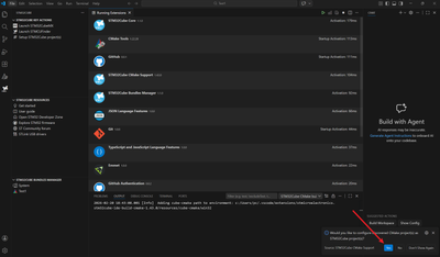

When opening a project directory in VS Code, the STM32CubeIDE for Visual Studio Code extension gets stuck in an infinite loading state (as shown in the screenshot below).
Symptoms:
  • "Go to Definition" does not work.
  • The Build Analyzer view does not appear.
  •  clicking the "Build" button still triggers a successful compilation.
  • Most dependent extensions, such as STM32Cube CMake Support, remain inactive
Here is the log output from STM32Cube Core during the failed loading:

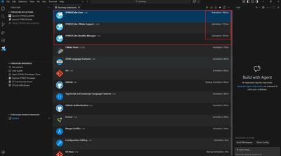

No, this extension only fails to activate when I open an STM32 project. If I don’t open any folder, or if I open a folder that does not contain an STM32 project, it activates immediately:

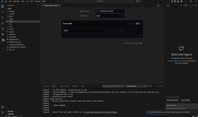

I also tried creating a new STM32 project with the MCU STM32G431VBT6. The first time I opened it, the extension activated successfully and quite quickly:

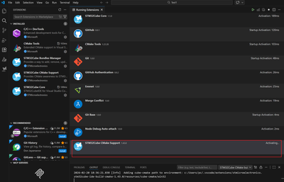

However, after closing VSCode and opening it again, it gets stuck during activation on the STMicroelectronics.stm32cube-ide-build-cmake extension:
