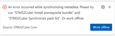

Just upgraded to the latest version of STM32Cube for VS Code extension (3.6.4) and now the extension stopped to work. I've tried reinstalling the extension pack several times. Every time after the bundle was installed an error show up saying "An error occurred while synchronizing metadata. Please try run "STM32Cube: Install prerequisite bundle" and "STM32Cube: Synchronize pack list". Or work offline."
Running "STM32Cube: Install prerequisite bundle" from the VS Code command palette will result in a message saying "No STM32Cube bundle to install", subsequently running "STM32Cube: Synchronize pack list" will return the original metadata synchronization error.
I checked my HOME/Library/"Application Support"/stmcube/ directory, the bundle/ folder seems to contain what I expected, things like cmake, gnu-gdb-for-stm32 or the stink-gdbserver, etc. However, the packs/ folder is empty, not sure if that's the problem.

at this point I am pretty sure the problem is st's server hosting APIs for accessing the device packs. a simple curl https://developer.st.com/st-pack-server/api/v1/ would return a html with the following content: "
An error occurred while processing your request"
hopefully st can address the problem asap this Monday.

We acknowledge the issue, technical Teams are analyzing it.
No bundles nor packs were published late last friday, neither during the weekend.
We will post here any further information.

Fyi the infrastructure has been fixed, cube pack sync should be ok now.
Apologies for the inconvenience.
