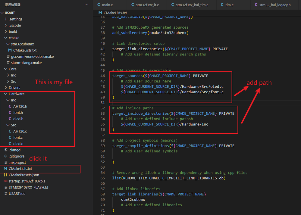

I try to do a little code for STM32F103 MCU using Visual Code Studio with STM32 VS code Extension.
I can generate and compile base code using STM32CubeMX importation feature.
But I'm stuck with adding external libraries to the project.
What i've done is to modify the "c_cpp_properties.json" file of the project to add the path to the library I want to use.
Here the current file :

But when I include the ssd1351.h header in the main.c file, it fail :
#include "ssd1351.h"
/* USER CODE END Includes */
Can someone point me to the solution for including external libraries in an VScode project ?
Thank you
11 REPLIES 11
However, when you regenerate the project using CubeMX, any paths you added in the cmake folder will be overwritten.
