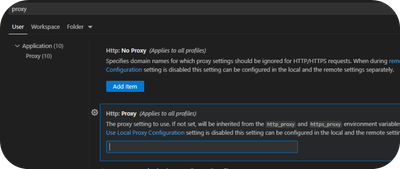

If you are hidden behind your company security, you probably need to configure a proxy and certificate to be able to access servers and download packages
This is how you will succeed in having full server access with our STM32Cube extension for VSCode.
How to Configure the proxy:
  • Open settings and type proxy in the search bar
Put your proxy in this format http://user:pass@Proxy-address:port

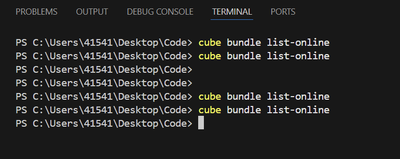

Could you open a vscode terminal, execute the command cube bundle list-online, and paste here the error if any ?

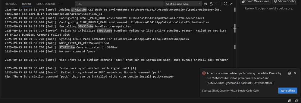

Hi @Julien D ,
Here is the STM32Cube Core error log, thanks!

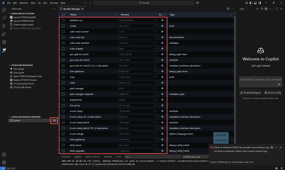

If I excute command STM32Cube: Install prerequisite bundles, it will report Failed to initialize STM32Cube bundles. Some feature may not work as expected. Please check output channel logs.
If I click Bundles Manager, the list can be opened.
The main error output seems to be truncated :
Failed to initialize STM32Cube bundles: Failed to list online bundles, reason: Failed to get list of online bundles. Command failed with
Then next commands fail because of that. For sample the pack command is missing because it is part of pack-manager bundle.

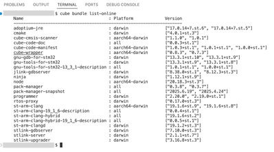

Can you open a VSCode Terminal and enter cube bundle list-online command to see if output is more verbose ?
Here is what you are supposed to get:
I input the command and run it, and it show nothing.
This is not expected at all, let me check that with the Team and I’ll get back to you.

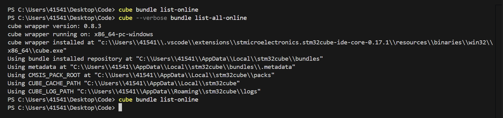

Could you give a try to another similar command enabling more verbosity and listing all platforms/architectures bundles: cube --verbose bundle list-all-online
Hi @Julien D ,
I try the commands, and it output more information on this picture.
Existed path:
C:\\Users\\41541\\AppData\\Local\\stm32cube\\bundles
C:\\Users\\41541\\AppData\\Roaming\\stm32cube\\logs

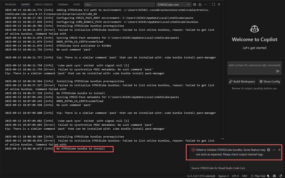

Not existed path:
C:\\Users\\41541\\AppData\\Local\\stm32cube\\bundles\\.metadata
C:\\Users\\41541\\AppData\\Local\\stm32cube\\packs
The attachment is the log files, please check. Thanks!
