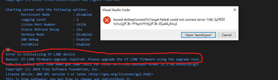

bound doStepStartGdbServer Failed: Failed to list bundles
wang_jingbo
 reason: Error: Failed to get full list of project bundles to install. Command failed w

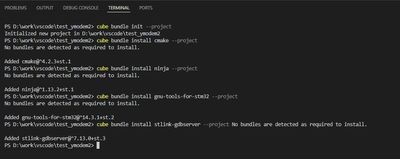

I have done the procedures as you instructed as below
the results said "No bundles are detected as required to install", just added all the tools.

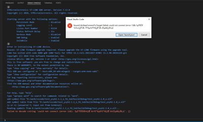

then I clicked [Run and Debug], below is the log
[bookmarks] Loaded 0 bookmarks

but when I choose the [STM32Cube: STM32 Launch STLink GDB Server, still I got the error

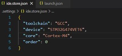

I wonder if you removed .settings/ide.store.json as well.
Can you try to setup the project again?

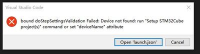

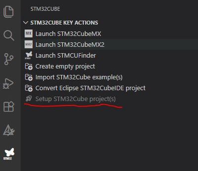

Hi @Julien D ,
Yes I have removed .settings/ide.store.json, after excuted the cube bundle commands, I only got 2 json files under .settings. as below
my setup STM32Cube project(s) is gray, it is not active, cannot setup as below.
Thanks. 
Create it with this minimal content and restart VSCode:
  "toolchain": "GCC"
BTW I assume you are using the latest STM32Cube extensions versions?
@Julien D
Hi, yes I created the file and input the minimal content, and restart VSCode, choose device and click setup STM32Cube projects(s), save it. now the file is as below.
and I click [Run and Debug], get a result like:

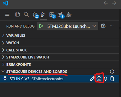

Hi @dqsh06,
I see in the debug console that the ST-Link firmware is not up to date.
Please update the firmware using:
Kind Regards,
/Flo

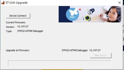

I am using stlinkv2, so I have download the latest ST-LinkUpgrade tool and upgrade my st-link tool to the latest firmwire as below
I will try vscode + run&debug, let's see what will happen. 
Thanks.
Hello @Florent V , @Julien D ,
After I updated the stlinkv2 firmware to V2.J47.S7, click [run and debug], it really can download the image and do the debug.
Thanks you all!
