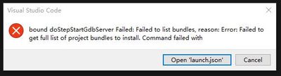

bound doStepStartGdbServer Failed: Failed to list bundles
wang_jingbo
 reason: Error: Failed to get full list of project bundles to install. Command failed w
Steps I've already tried
Windows11
  1. Verified the project path contains no Chinese characters, spaces, or special symbols.
  2. Cleaned and rebuilt the project (CMake/Make workflow).
  3. Reloaded the VSCode window
  4. Confirmed the executable file was generated successfully, and the program path in launch.json points to the correct file.
Questions
  1. What exactly causes this "Failed to list bundles" error during debugging?
  2. Is there a standard, correct launch.json template for this scenario on Windows?
  3. Do I need to configure additional GDB paths or environment variables?
  4. Are there any other troubleshooting steps I should try?
Thanks a lot for any help or suggestions! :folded_hands:

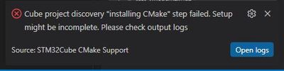

@Cartu38 OpenDev
@wang_jingbo
hello, I have uninstalled stm32cubeCLT, and made a path to stm32cube\bundles with the PC environment variables, then when I click build, I can get the gcc using bundles as below
[cmake] -- The C compiler identification is GNU 14.3.1
[cmake] -- The CXX compiler identification is GNU 14.3.1
[cmake] -- Detecting C compiler ABI info
[cmake] -- Detecting C compiler ABI info - done
[cmake] -- Check for working C compiler: C:/Users/Lenovo/AppData/Local/stm32cube/bundles/gnu-tools-for-stm32/14.3.1+st.2/bin/arm-none-eabi-gcc.exe - skipped
the problem is every time I openned the vscode i got a popup box as below
it said installing CMake step failed. but actually, I have installed the stm32cube/bundles/cmake/4.2.3+st.1
and the logs as
2026-03-17 09:19:21.525 [Info]  Adding cube-cmake path to environment: c:/Users/Lenovo/.vscode/extensions/stmicroelectronics.stm32cube-ide-build-cmake-1.44.0-win32-x64/resources/cube-cmake/win32/x86_64
2026-03-17 09:19:24.053 [Error]  Failed to list bundles, reason: Error: Failed to get full list of project bundles to install. Command failed with
2026-03-17 09:19:24.927 [Info]  Activating STM32Cube configurations for the code indexing feature...
2026-03-17 09:19:24.936 [Info]  Configuring code indexing for 'd:/work/vscode/test_ymodem2'
2026-03-17 09:19:25.024 [Warn]  Active project is not STM32Cube ready, not applying STM32Cube configuration
it said "Failed to list bundles",  I don't know what is this means.
so what is wrong?
Thanks.
Thanks.

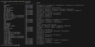

@dqsh06
Are you able to reach remote bundles server ?
cube bundle list-online
You need to be online to get the stuff works see https://community.st.com/t5/stm32cubeide-for-visual-studio/connectivity-issues-of-stm32cubeide-for-vscode/m-p/862035#M1583
Any trace as part of STM32Cube core output channel ? Any spurious stuff looking at devtools console ?

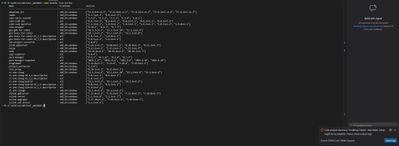

@Cartu38 OpenDev
yes, I can reach remote bundles server.  as below, but still indicated "installing CMake" step failed.
the log is
I don't know why it is, maybe this is a bug of stm32cubeide for vscode.  it is very diffcult to use this version of stm32cubeide for vscode.
Thanks.

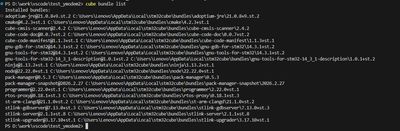

Hi @dqsh06,
In order to investigate your problem more deeply, may I request you to clean up your project by removing the .settings/bundles* files, the .vscode/ folder, and the build/ folders?
Then, please try to perform the Setup Project from the CLI by following these steps in the VSCode integrated terminal:
$ cube bundle init --project
Initialized new project in xxxxx
$ cube bundle install cmake --project
Added cmake@^4.2.3+st.1
$ cube bundle install ninja --project
Added ninja@^1.13.2+st.1
$ cube bundle install gnu-tools-for-stm32 --project
Added gnu-tools-for-stm32@^14.3.1+st.2
$ cube bundle install stlink-gdbserver --project
Added stlink-gdbserver@^7.13.0+st.3
Your error message suggests that the second command is failing. Running it separately might provide a clearer explanation of the cause.
