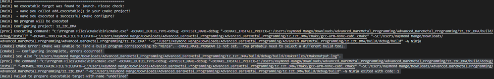

I am getting the following output in the terminal, when I hit f5
what may be the issue?

Hi @RMang.1​
seems to be a path issue could try with a shorter path which doesn't contain spaces

‎2023-03-23 4:29 PM
Was this project imported with the STM32 extension? The latest should have vcpkg bundled in one of the extension dependencies which would satisfy the cmake and ninja dependencies.
